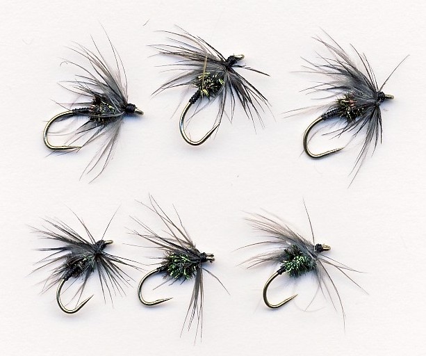

My experiences have been that purple and brown Pearsall Gossamer silks get darker when wet (think of WC Stewart's "Black Spider") and thus, when wet, look almost a black color.
One of my favorite spiders / soft hackles is an old UK dressing for a "Black Magic Spider" with a black thread body; peacock herl thorax (with a few wire wraps below the peacock herl); and a black hen or starling hackle. Would think using a purple silk instead of black thread might also make a good fly (hmmm, maybe Purple UV Ice dubbing for the thorax might be good!).
Black Magic Spiders.jpg (96.26 KiB) Viewed 3356 times

Maybe 15+ years ago, a fellow in the UK sent me the info for this dressing, which I tie, as follows:
Hook: Daiichi 1550 size 16
Body & Head Thread: Black Danville 6/0
Underthorax: Usually very thin red copper wire
Thorax: green peacock herl
Hackle: I prefer starling with the fuzzy stuff still on the hackle (black hen can be subbed)
The red wire unde the thorax adds a little weight to get the fly down a little lower in the water without sinking it down like a nymph. I do maybe 6 - 8 turns of the red wire and tie it in as soon as I tie in the black Danville thread, so that the thread secures the wire to the hook. I then wrap the thread down the hook shank and back up to the wire; tie in the green peacock herl and then do a few wraps of the herl.
I tie in the staling hackle by the tip and then wrap all of the hackle until the "fuzzy stuff" is at the front of the hackle; then whip finish and add a drop of cement.
This has been a very productive fly for me and for several of my fishing buddies. If you use a black dry fly hackle and a small black tail, makes another nice dry fly when all the little black stuff is on the water.
