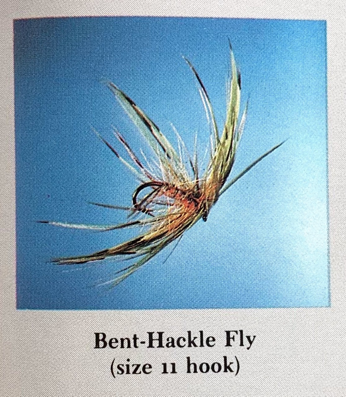

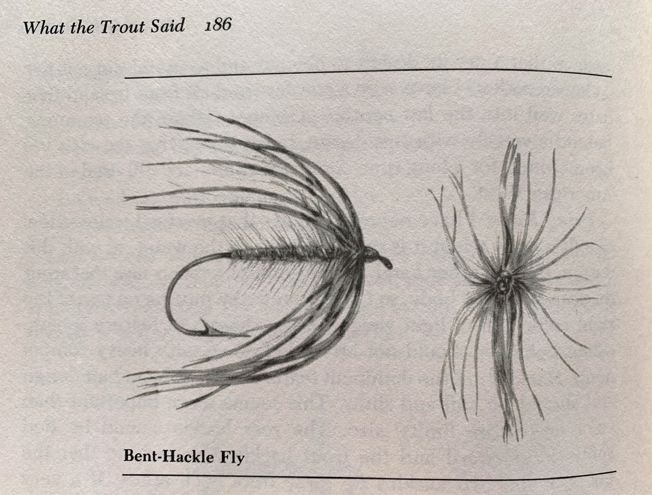

Link discussing Datus Proper's "Bent Hackle" pattern: https://www.sparsegreymatter.com/viewtopic.php?t=5324
Book Reference ("The Fly-Fisher's Craft: The Art and History"/By Darrel Martin): https://books.google.com/books?id=nmKCD ... le&f=false
I know what you mean by how the fly looks unfinished, but this is by design (the way I want it to look). I want enough stiff hackle in the thorax region, to allow the fly to sink slowly (the stiff dry fly hackle will create drag, slowing the sink rate of the fly and cause it to drift with the current more closely). Yet I wanted the back end of the fly unhackled, so it would tend to ride bend downwards once it sinks below the surface (hopefully more like a natural insect hanging in the drift).
Datus Proper wrote about a "Bent Hackle" pattern, which is essentially the same as the jingler. The fly has a collar of soft hackle at the front, supported by stiffer body hackle.

Dates Proper’s Bent Hackle Fly:

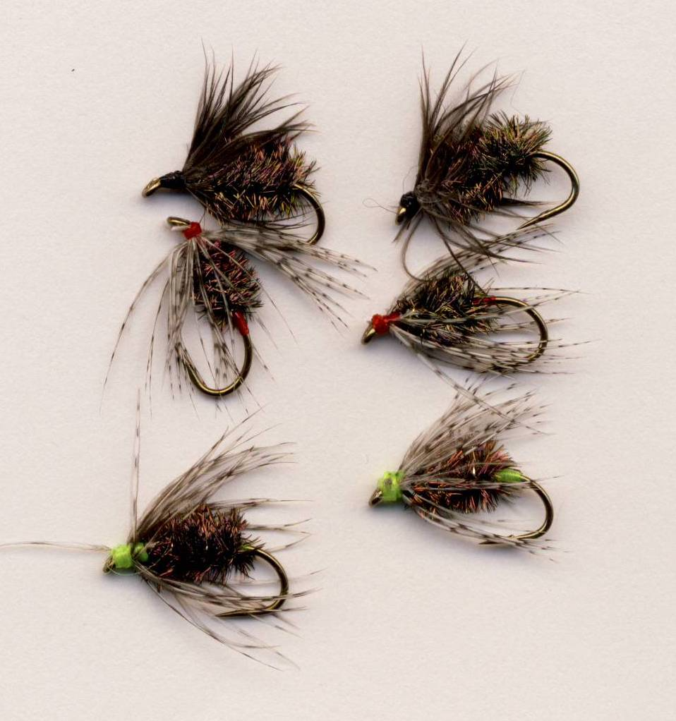

A couple comments:
The "Buzz" fly looks like my Crackleback variation with a partrdige hackle up front. I think I tied a few of these years ago but not sure. Since I'm now tying CBs, will have to add a partridge hackle to a few.
Peacock bodied flies have been some of my most effective flies for several years. I tie 3+ versions, basically all the same except for the thread. An "Egg Laying Caddis" with FL. Green or Torquise thread; a "Red A _ _" with red thread: and another with black thread.
In ttying all three versions, I wrap the thread part way down the hook bend before tying in a gold wire and the peacock herl. After wrapping the peacock herl body and counter wrapping the gold wire, I add a partrdige hackle and finish off the head with the thread. So all three have "Colored thread" butts and heads and the same body and hackle, only difference being the color of the thread
Sometime, just for the heck of it, I'll vary the hackle and use brown, black, etc. hen hackles. Since the enclosed pic was made, I now wrap the threads further down the hook bend to add a more distinct butt!
Peacock Bodied Soft Hackles.png (1.13 MiB) Viewed 4884 times
