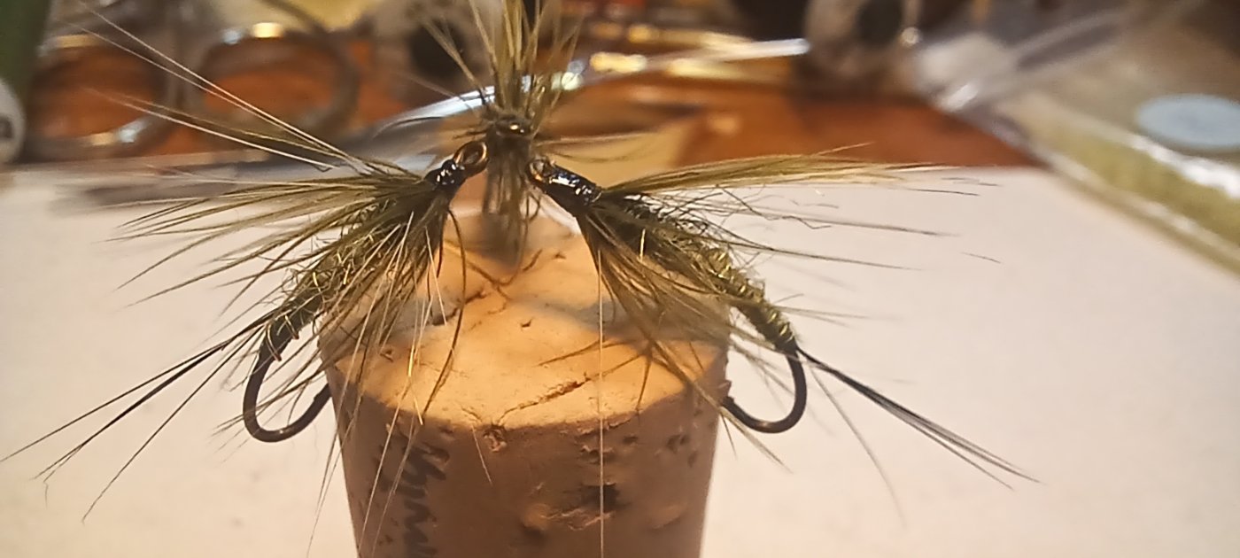

This Mustad 3x long curved #12 is allows tying around the bend, maybe giving the tail the illusion of movement. Ill soon see what effects these Green Drake patterns have on the fish.

1Equinoxclan, Howdy;
Need to re do the image. The description sound very good.

Those are amazing and your spinners are something I will attempt to copy.
I've been chasing Drakes as they progress up a tail water system for a week and those flies would crush.

Re: Green Drake Emergers
Great looking flies!!

Well done!
I like sparsely tied flies.
Wow! Those look buggy for sure. I'm surely going to copy those and try them on the Cache La Poudre. I have this gut feeling they'll work really well.
Steve - Could you please share the recipe with us? I would like to try these as well. Wonderful pattern.
Hook Mustad C53S 3xlong curved #12
Thread Veevus black
Tail black cock hackle
Rib medium gold wire
Abdomen Hareline trilobal Damsel green (tight) teased out (tied around the bend)
Thorax Hareline Senyo laser black , damsel green mix loose dub to pull or tease out to sparse wing size
Hackle 1 turn cream badger , 1 to 2 turns olive hen
Cheers Steve
Thread Veevus black
Cheers Steve
Nice simple pattern for the big bugs. The attention to detail is obvious. Thanks for sharing this one.
