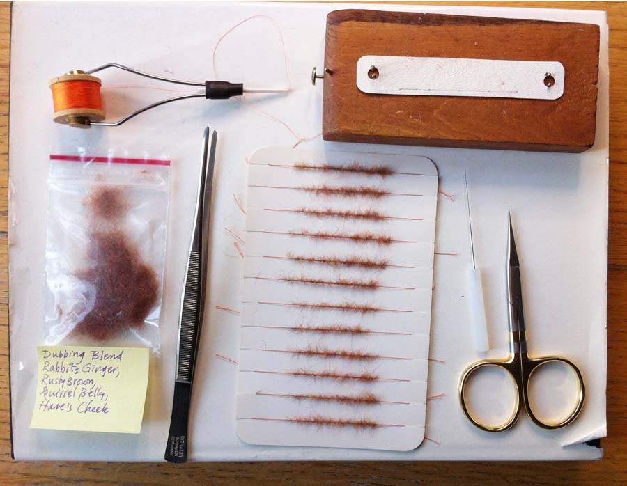

Last night after tying three dubious March Brown variants, I spun a dozen bodies of a darkish brown blend of rabbit and hare, from ginger-yellow to natural hare's cheek to some darker reddish brown. Looks boring from a distance, but sparkles with color up close. I'll use them tonight, along with some of the feathers I found.
Ginger
This is my set-up for spinning bodies. That's the Clark Spinning Block that my father used. Full of good vibes.

The tying epitomy of "A Chip off the Old Block", great work! Looking forward to seeing the finished flymphs!! 8-)

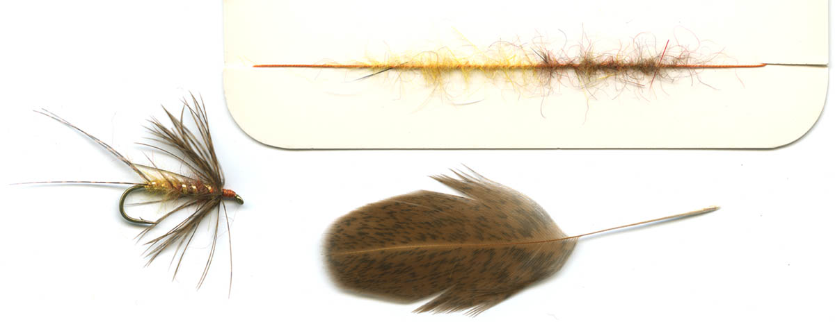

Been a busy week, but I've been working on this. Here's the result—not very refined, but better than before perhaps. I opted for a two-tone body, like Tups.
Suggestions welcomed, as always.
Hook: Tiemco 5263, size 12, 2X heavy, 3X long
Thread: Pearsall's gossamer Hot Orange, vintage on wooden spool, real orange, not the yellowish replacement
Hackle: India Hen Back, Natural
Body: Light blend, dyed rabbit, ginger, yellow, and Squirrel belly. Dark blend, Hare's cheek plus dyed rabbit, ginger, rusty brown and squirrel belly. On Hot Orange silk
Rib: Lagartun varnished French Tinsel, Oval, X-Strong, Medium
Tail: Hooded Merganser
GingerDun

Post by Roadkill » Sun Jan 22, 2012 2:08 am
Beautiful fly only one thing to improve it-take it fishing! 8-)
