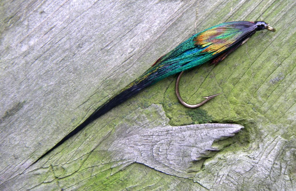

Black Sword Soft Hackle
Posted: Sat Dec 10, 2011 10:58 am
Hook - Mustad Model R50-94840/Size 10
Abdomen/Thread - UNI-Stretch (Black)
Tag/Rib - Sulky Sliver Metallic Tinsel (Silver / No. 8001)
Tying Thread - 8/0 UNI-Thread (Black)
Thorax - Hares Ear Dubbing (Black)
Hackle - Peacock Sword Fibers (well waxed thread dubbing loop used to form hackle collar)
Abdomen has been coated with two layers of Loctite Super Glue to protect the body and make it more durable for fishing.
If I tye this fly again, I would use less peacock sword fibers (maybe 8 or 9) and I would add another couple coats of super glue to the body (not smooth enough for my taste).

Thanks Mark. Once the body and thorax of the fly has been tyed, I waxed about three inches of the tying thread with tying wax and then formed a short dubbing loop (roughly 1.5 inches long). I then clipped a half-inch long section of peacock sword, leaving the sword fibers on the main stem. The stem acts as a handle to hold the fibers in place while positioning them in the loop. Insert the sword fibers into the waxed dubbing loop and adjust them to the length you want. Gently twist the dubbing loop a couple times, just enough to hold the sword fibers in place. Trim off the butt ends and the hackle stem. You want to trim the sword fibers very close to the thread dubbing loop (1/16th to 1/8th inch). Now twist the dubbing loop until the sword fibers are locked into place within the dubbing loop. You can now fold the sword fibers back and wrap them as you would a normal hackle (think of the thread dubbing loop as the stem of the feather).

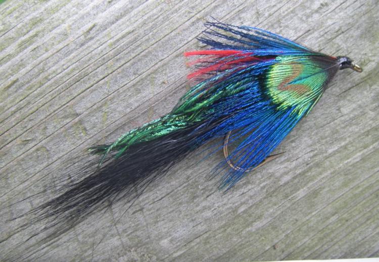

Bob - Thanks for the suggestion. I will give it a try. It will be interesting to see the Alexandra as a soft hackle. I love that pattern. A few years ago, I converted the Alexandria over to the Australian "Killer-style" lure.
Alexandra (Killer Style).jpg (78.25 KiB) Viewed 5198 times
Alexandra (Killer Style) - 1.jpg (208.64 KiB) Viewed 5202 times
http://www.flytyingforum.com/pattern6799.html
http://www.classicflytying.com/index.ph ... =Alexandra

That Killer style slims down quite nicely when wet, doesn't it?
