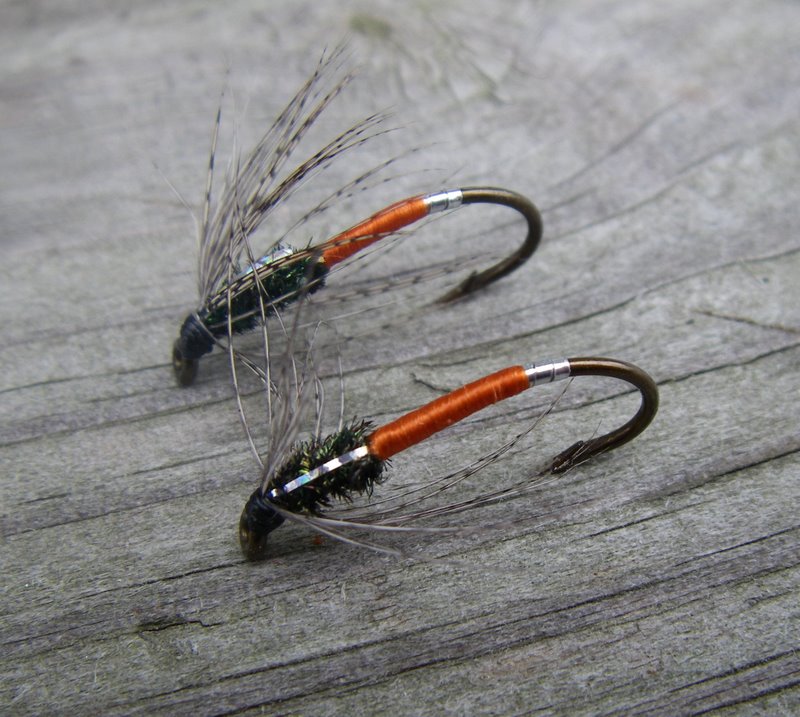

POP (Partridge-Orange-Peacock) Fly
Hook - Mustad Model 3906 (my favorite is Size 6)
Thread - Black UNI-Thread (6/0)
Underbody and Tag - Silver Tinsel (Holographic looks nice too)
Rear Body - Kreinik Sole Platte Silk wrapped over the silver tinsel
Wing Cover - Single strand of Holographic Flashabou
Front Body - Peacock Herl (reinforced in a dubbing loop)
Hackle - Partridge Body Feather
Head - Black tying thread sealed with head cement
Note about the name of the fly:
POP = Partridge-Orange-Peacock
PPP = Partridge-Purple-Peacock
PRP = Partridge-Red-Peacock
PGP = Partridge-Green-Peacock
PYP = Partridge-Yellow-Peacock
PBP = Partridge-Blue-Peacock
and so on... I've also had good luck with bronze and gold colored silk over gold tinsel.
Tying Instructions:
- Start the tying thread at the eye of the hook (five wraps only).
- Prepare a partridge feather (strip off the fluff at the base of the feather) and tye it in facing out over the eye of the hook.
- Wrap the tying thread back to the midpoint of the hook shank.
- Tye in the tinsel at the midpoint of the hook (five wraps).
- Wrap the tinsel back to the rear of the hook and forward to the tying thread. At this point I unwind the thread 4 wraps before tying off (reduces bulk) and cut of tinsel tag.
- Tye in the silk at the midpoint. Wrap the silk towards the back of the fly, leaving a small silver tag at the back of the fly. Wrap the silk forward to the tying thread and tye off and trim excess.
- Tye in two strands of holographic flashabou which will later form the wing case of the thorax and a couple tinsel legs.
- Run the tying thread forward to the eye of the hook and tye in three to five strands of peacock herl by the tips.
- Run the tying thread back to the midpoint. Form a dubbing loop and twist the peacock herl in the dubbing loop. Wind the herl rope forward towards the eye of the hook, forming the thorax. Leave room roughly one eye length gap for the hackle and head of the fly. Tye off the herl and clip off the ends.
- Pull the strands of flashabou are pulled over the back of the fly to form a simple wing case (flash points/"attention getters").
- Clip the end of the partridge hackle in a hackle pliers and fold the fibers of the hackle. Wind two turns of hackle back towards the thorax tying thread.
- Wind the tying thread through the hackle (wiggle it back and forth so the fibers are not matted down). Clip off the excess tip of the hackle.
- Pull back the hackle fibers with your thumb and fore fingers and form the head. Wrap the tying thread over the base of the fibers to make them sweep backwards and strengthen the stem of the feather.
The idea of having the tinsel underbody (to make the silk look more translucent from the light reflected back from the tinsel). John Dunn used in his "Sunshine Oil" to get a similar effect. I have been temped to try a small drop of olive oil, or vegetable oil on the silk to see if it made the silk look different, but I've never tried it.

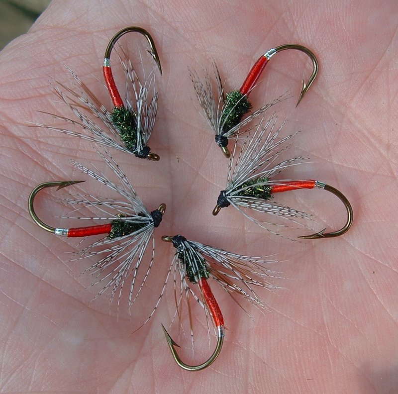

I have been playing around with these flies, and I now give the silk a thin coat of superglue. I bought a small bottle of Locktite Super Glue, which has a nice brush applicator. I find that the super glue makes the body smooth as glass and makes the silk body very durable. After you finish the rear body (before beginning the thorax section), give the body a light coat of super glue and set it aside to dry. Tye up another one and coat it in the same manner. By the time you tye the rear body of the second fly, the first one will be dry and you can then finish the first fly. It takes a few minutes longer to finish each fly, but they are much more durable and will save you a lot of time on the stream.
If you look carefully at the photo of the red ones, these flies had the superglue treatment on the silk. Once you get the hang of it, they should all look like the fly at the 1 O'Clock position (nice smooth body).
Durability is one of the reasons I started giving the rear body (silk part) a thin coat of super glue. I did not want to rib the fly or tye any band over the back of the fly. This type of silk has a tendancy to get frayed after a half dozen fish (or one with really big teeth). The super glue has eliminated that issue and maintains a rib free abdomen. I've tryed tying the fly with a rib over the silk and I just like the appearance better without the rib. If you use a rib, I recommend using a metal rib (flat tinsel) instead of mylar tinsel. I've found the metal tinsel to be more durable than the mylar tinsel.
