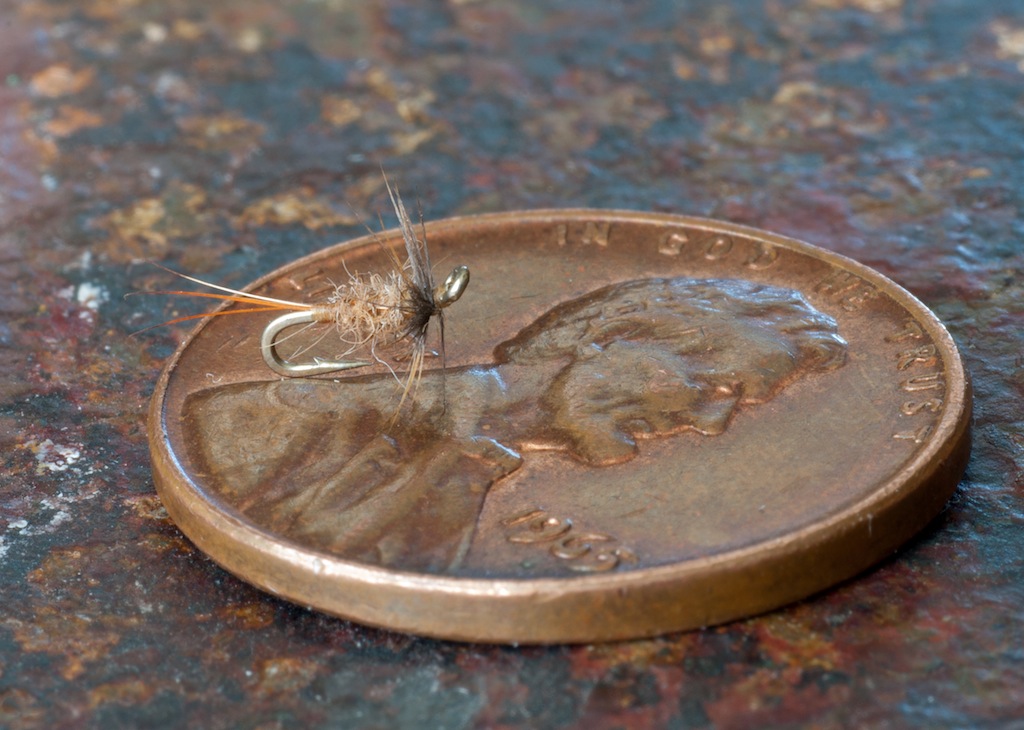

Last year at a show I had a guy come by, bend over, look my display flies and comment, "those are too big". Then walk off without saying anything else. I just chuckled, most of my flies are #14-#18. I found some hooks this weekend, #24 Daiichi 1330's. I thought of this guy and had to buy some for fun. I tied this as a traditional flymph. Premade dubbing strand and all. Just to see if I could.
The Wee Flymph
Hook: #24 Daiichi 1330
Thread: Griffith's 14/0 ginger
Tail: light ginger dry fly hackle barbs
Body: light hare's ear
Hackle: Whiting genetic hen cape, rusty dun

Carl, I was just saying to a friend asking about the advantages of the prespun bodies, and the best uses, that anything smaller than a #16 or #18 would be best created using a touch dub or split thread technique, because the two layers of gossamer plus dubbing would be too much, in my (now reversed) opinion. You blew that comment out of the water. this is just killer. I don't think I could manage it, but I'm excited to see you have. What a useful little pattern. Nicely done. Bravo.

I would not have even tried split thread on one of those wee hooks, let alone be able to pick the damn things up in my Neanderthal like digits.
Beautiful wee flymph that should be just the business for picky trout.

Well William you are partly right. I don't think you could do it very well with Gossamer. I used the Griffith's 14/0 thread and had to be very intentful with each wrap. To make the dubbing strand I waxed the thread with a sticky wax, touch dubbed the hare, extremely sparse, took me a few tries, then twisted the strand. It was pretty matted when I tied it in so I had to pick the hare out around the body.

Carl - Bravo! I can't get over how perfect the proportions are on such a tiny iron. VERY impressive.

To be honest Ray, I think I just got lucky. I didn't dare try to tie another one.
