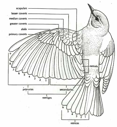

Yes, The "bastard wing" is also called the "alula". It is on top of the bird wing. See the diagram, below. There can be a number of usable feathers on that small portion.

CreationBear
Posts: 1156
Re: Partridge Breadcrust
Post by CreationBear » Sat Nov 20, 2010 10:56 pm
Great diagram--that helps a lot. I'd love to know the etymology of "bastard wing," though. :)
