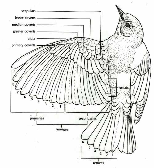

by Soft-hackle
Hi CreationBear,
Yes, The "bastard wing" is also called the "alula". It is on top of the bird wing. See the diagram, below. There can be a number of usable feathers on that small portion.
Mark
Re: Partridge Breadcrust
Posted: Sat Nov 20, 2010 10:56 pm
by CreationBear
Great diagram--that helps a lot. I'd love to know the etymology of "bastard wing," though. :)
