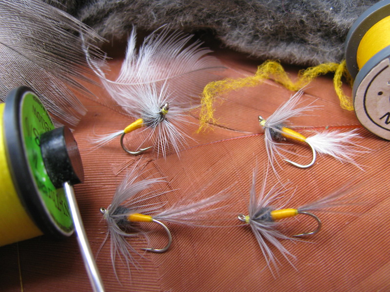

Some ideas can be extracted from here:http://www.classicflytying.com/index.ph ... opic=40180
I am not familiar with the site, but I recognize Alex F as a knowledgeable guy from elsewhere. I would interprete his Large Dark Olive suggestion as a rather slim fly. I am unable to follow the link to the pattern tied.
Roger Woolley lists it as an "Early Olive Pattern". The fatter versions are probably a 'modern' thing.

I interpreted it Alex F's as a slim profile as well. I am registered on that site but can't get the picture to load either. I know Geert, I will see if I can get a shot of it. He is an exquisite tier.

Post by Old Hat » Tue Jan 14, 2014 5:34 pm
Here is the photo to go along with the commentary. Geert also tied a dry in the group.
