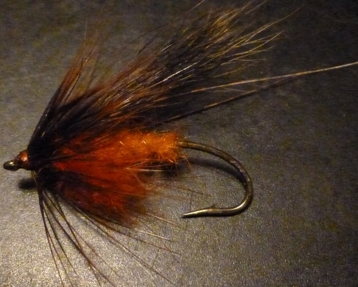

Inspired by Ray's pattern. Here's one that is working good for me this year.
October Flame
Hook: #8 TMC 200R or Dai-Riki 889 (Depending on location, naturals are #8-#10 – #8, where I fish – For big water holding large trout or sea-runs, I like a heavy wire steelhead hook, though a lighter hook might be more appropriate for trouting, skinnier water & smaller sizes.)
Thread: Rust-brown UNI 8/0
Rib: Fine copper wire
Body: Mix of 2/3 Umpqua orange sparkle dubbing & 1/3 Wapsi Superfine sulfur yellow dubbing, dubbed in a loop of the tying thread (Pumpkin orange on my home water, & that seems to be fairly common over the northern regions, though color will vary with location, pale orange to tan & yellow more common to the south into California. A wingless version of this pattern will fish for the pre-emergent pupae, but keep in mind that these are paler in coloration than the adults – a common mistake tiers make is representing the pupa with adult coloration – mixing in more of the sulfur yellow will give the lighter coloration.
Thorax: Flue taken from the base of an orange-dyed mallard flank feather – tie in around the center of the puff then fold back & arrange around the hook shank – the flue from one side of the feather tied in on top, & the other side tied in on the bottom usually does it, though it might take a bit more – this will extend over about half the body & when wet creates an enticing shroud
Antennae (Hind legs?): 2 mottled turkey tail fibers extending well behind the hook bend
Wing: Pine squirrel tail
Hackle: Furnace hen

Re: October Flame
Steve,
This is a very nicely thought out pattern. I like the thorax addition and the attention to detail in the antennae.
I haven't seen a lot of traditional hairwing wet flies for trout. Of course there are a lot of hairwing streamers and not enough people fish these in small sizes IMO. I do tie few attractors for trout that are small versions of some of the classic hairwing steelhead patterns. Most of the small hairwing trout flies seemed to be traditionally dry patterns. I'm interested to see what you come up with.

Re: October Flame
Steve, this looks like another interesting combo. I can definitely see the steelhead potential here. Trout too. Great to hear it's been working for you and great to see a hair wing. It's unique to me and very cool. Looking forward to more reports.
Re: October Flame
Steve,
This one is a beauty! I like it alot! Really well done! Please tie more of your handiwork and post it here!

Re: October Flame
"Well thought out" describes this to a T. Amazing.

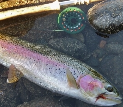

Thanks for the encouraging words guys. If I can manage some half-way decent fotos, I'll try to post some more examples of the hairwing wetflies I'm tying.
Yes, UC redbands seem to prefer the winged version, & our fish count has gone up since we've started using them. I think there has been a lot of confusion regarding October caddis, & that reinforced by writers who insist that this insect crawls from the stream to complete emergence. And yes, that is one of its hatching strategies, particularly on streams possessing shallow bars with finer sediments. But these are an incredibly adaptable bug employing more than one strategy, depending on stream geology, for the most part, I suspect. October caddis are abundant in the UC & an important hatch here, & the imitations bring up some of the biggest trout of the year. The river here has very steep banks dropping off to deep water quickly. The river bottom is a rubble of skull-sized stones which offer the transitioning pupae safe shelter from the trout. The shoreline stones are inhabited by a bazillion hunting spiders waiting to engage any helpless bug emerging from the river. Crawling out of the water to transition would not be the best strategy here, & that evidenced by the fact that you find very few OC casings on the riverside stones. But you do see a lot of the big caddis emerging from the water, where they rise from the bottom fully winged. The winged emergers are strong swimmers & move quickly through the water column, which is probably why the winged pattern makes a good swinging fly, the swing & lift simulating the movement of the natural flymph.
