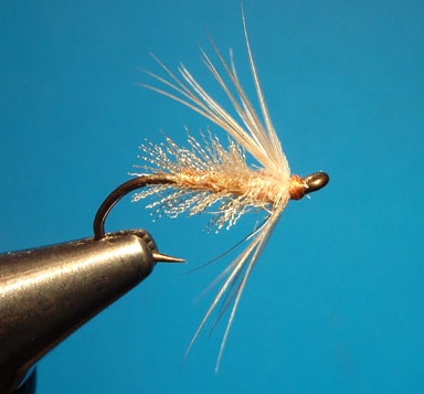

Organza Softy
Posted: Sun Feb 22, 2009 7:33 pm
by BruceC
Organza Softy
Hook: Gaelic Supreme Syl Nemes Size 13 U-Eye
Thread: Pearsall's Gossimer, Chestnut
Hackle: Ginger Hen
Abdomen: Stripped organza (ala Bill Logan) palmered over tying thread
Thorax: SLF #48 Natural Seal
Repost
Cheers,
Bruce

Here's a repost of the directions for tying the organza body:
Organza ribbon can be found at any craft shop, Walmart, etc. The rolls of ribbon will vary from 1/4" wide to 2". Make sure not to purchase a ribbon that has a wire edge that helps to hold the shape of a bow. You want the one that has a soft edge to it. Take a 6 inch strip of ribbon and lay it flat. With a straight edge and razor, cut the long way, about 1/8" from the rib (finished edge). This will leave you a 6 inch long strip that has the rib edge and about 1/8 inch of the weave. Take a bodkin, and start picking out the individual strands of the weave in the long direction. When you have all of them removed, you'll be left with the ribbed edge and the short fibers sticking straight out. You can then wrap this like a hackle either in touching turns, or palmered, etc.
I'll try and find some other references to this process. Bill Logan came up with the idea, and Steve Thornton picked up on it. The process appears in Steve's first book, Listen to the River, Vol.1.
Cheers,
Bruce
