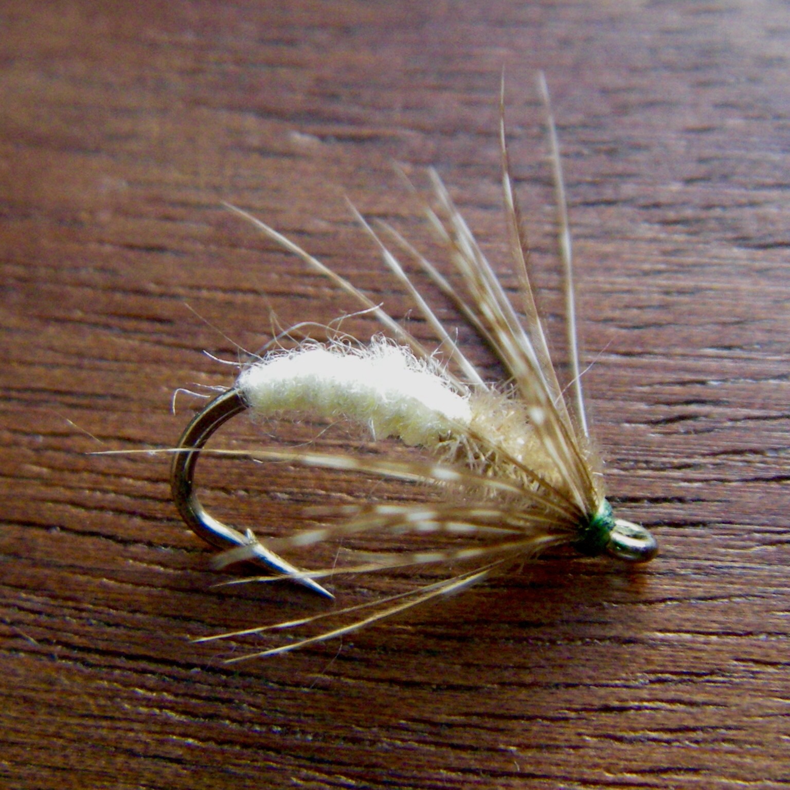

This pattern is my first attempt to match the little pale yellow mayfly I saw last weekend.
Creme Brûlée
Hook - Daiichi Model 1150/Size 14
Thread - 8/0 UNI-Thread (Light Cahill)
Hackle - Hungarian Partridge (Bleached/Ginger)
Thorax - Three strands of Peacock Herl (Bleached/Ginger)
Abdomen - Kreinick Silk Dubbing (Pale Yellow)
Head - Colored Green with a Sharpie marker after whip finishing the head (done to better match insect)
Creme Brûlée
Re: Crème brûlée
Looks like a winner to me!
Re: Crème brûlée
Hi Ray,
Nice fly. Let us know if you catch anything with it. You use quite a lot of bleached stuf. I cannot buy it here in Europe or do you bleache it yourself??
Greeting
Ruard

Re: Crème brûlée
Ruard - I bought the partridge from Orvis, and the peacock from a store called JoAnne Fabrics. The materials were already processed to be this ginger/tan color. Now that I think about it, I believe they would use hydrogen peroxide, not bleach to achieve this color. Peroxide is sometime used to lighten a ladies hair.
Re: Crème brûlée
Great looking pattern Ray. I like the choice of hook as well.
Re: Crème brûlée
That matches up real well, Ray. Nicely done, as always.
Re: Crème brûlée
Two thumbs up! That partridge is nicely mottled.
