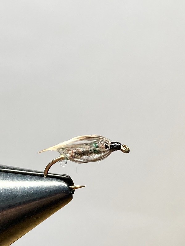

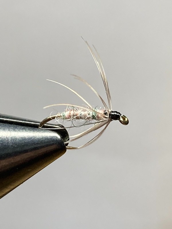

Here is a fly tied using Jamieson’s Shetland Spindrift wool, which has become quite popular in the fly tying community, especially since Chadwick 477 darning yarn, used in Frank Sawyer’s grayling bug, is no longer available.
I like tying with Jamieson’s Shetland Spindrift wool. It is very ‘buggy’ .
You can also see what it looks like wet.
Hook : Kamasan B405 size 14 (tied in 14/16)
Uni-thread 8/0 black.
One ply (strand) of Jamieson’s Shetland Spindrift Fog (272) wool tightly twisted for the body.
Starling hackle.
David

In my opinion the beauty of the Spindrift wool is that it is sufficient a dressing in its own right. I see no need to have a material underneath ‘showing through’. Unless you are tying a bug/nymph and require weight there is no need to use wire. The wool if twisted carefully is tough stuff. You can ‘rough’ it up to make it look even more buggy. This also helps it to retain air bubbles in the dressing - making it look even more natural - translucent even. Also by twisting it that creates a form of ribbing, again making it look even more natural.
You will also find the wool quickly absorbs water creating weight.
When you use the Spindrift wool you will notice it is made up of two strands. If you are tying a size 12 there is usually no need to split the wool, but for anything less I suggest you use one strand, certainly down and including an 18 or maybe a 20. However be aware that when you separate the two strands quite often you will find one weaker than the other, which is very irritating when you are halfway wrapping and it disintegrates!!! I usually give each split length a slight pull to check for a weak link before tying in.
However as you are creating a fly for yourself that will be lethal the beauty of tying your own is that you do it how you want. I do😁
Happy tying
