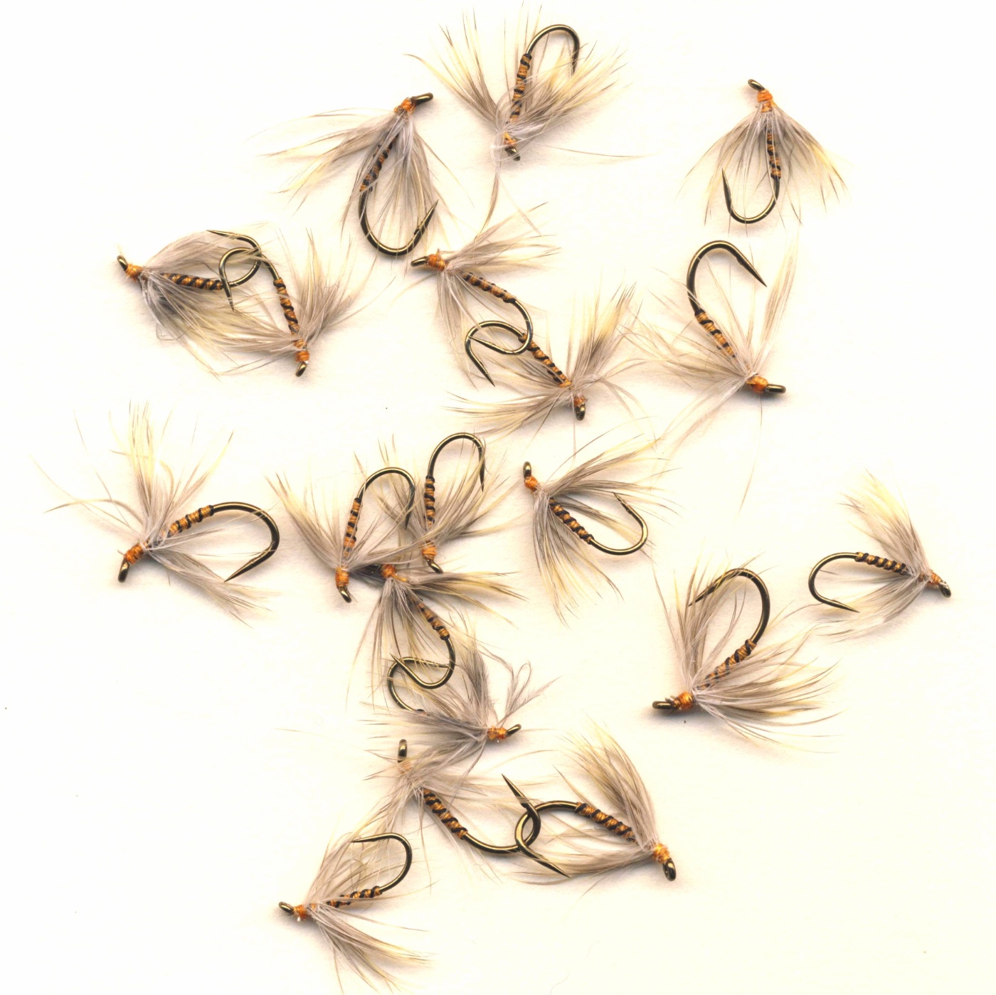

As promised, here's a pic the Water Crickets I tied last week.
- T E Pritt's No 1 Water Cricket.JPG (357.11 KiB) Viewed 8266 times

Worth the wait. Gorgeous flies.
Re: Golden Plover Breast Feathers
Very nice work, Bob. I noticed you vary your hook weights - this is an important technique which is rarely discussed. When a flymph in the film is the order of the day, I use either Partridge L3A or Daiichi 1480. For just below the surface, any medium wire Limerick bend, such as the Mustad 1921/1928/9002 is the ticket. Mid-water mandates a heavy wire hook such as the Daiichi 1760, or Mustad 7957BX. Also, the Mustad 3906B is a great "between" hook. Yes, weight may be added to the hook, but too heavy is not good either. Your fly must be where the fish are feeding!joaniebo wrote: Mon Sep 14, 2020 8:57 pm As promised, here's a pic the Water Crickets I tied last week.
Here is a good example:
A few years back, we were fishing Horse Brook Run on the Beaverkill. Situated between two of the most famous pools( Hendricksons and Cairns), HBR has three components: the top outflow run from Hendricksons, the middle pool where Horse Brook enters, and the lower riffle that takes you to Cairns. Unbeknown to most in the upper stretch are the three deep holes tight against the road, which always hold a few good fish. William, Carl and I fished there one fine October day - we crossed where the brook enters, walked upstream, the proceeded to fish down. Carl, then William, with me bringing up the rear. in the lower hole, neither Willian nor Carl had a pull; I managed a fat rainbow on a flymph tied on a Tiemco 2x heavy hook. My point is, the heavier fly caught the fish, because that is where they were feeding.
