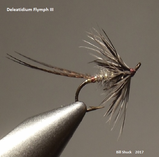

While I was scouting around on the internet looking for interesting patterns for the Lost NZ Flies swap, I learned that there is a medium sized mayfly of the family Leptophlebidae that is relatively common in cold, clean NZ streams and provides a significant portion of what trout eat in those waters. It is called “Deleatidium” and has two or three subspecies that provide working hatches during the year. It resembles, to my way of thinking, our isonychia (slate drake) mayflies, with longish tails and a streamlined greyish body. The wings are also grey, but unlike the monochromatic slate grey of the isonychia, the wings are variegated with black markings.
I had flymphs on my mind as a result of Carl’s suggestion for holding a flymph raffle to raise funds for IBF pins, and thought I might try to come up with a deleatidium flymph. So, I mixed up a batch of dubbing consisting of 70% kit muskrat/30% hare’s ear and spun some bodies on Pearsall’s #10 ash gossamer silk. Then I took a now-vintage Mustad 94842 Size #12 up-eye hook, tied in two hackles by their butts (one grey and one badger with one side stripped on each) using claret gossamer thread. I wrapped a tag of small gold flat tinsel, added three bronze mallard flank fibers for tails, tied in the tinsel again for a rib, added and wrapped one of the spun bodies, palmered up the rib, brought the hackles back together in three wraps, caught them with the thread, took two turns of thread through the hackle, and finished off with the signature cone head.
Here is the result (after three attempts):

Re: Deleatidium Flymph
Post by hankaye » Wed Mar 22, 2017 8:52 am
tie2fish, Howdy;
Mr. Bill, beautiful fly. The write up is also appreciated. Kinda fun to read the reasoning and
thought processes and the tying instructions behind the final offering.

Post by ScottP » Wed Mar 22, 2017 9:08 am
Beautiful tie; what kind of hackle is that?
Post by tie2fish » Wed Mar 22, 2017 9:48 am
ScottP wrote:Beautiful tie; what kind of hackle is that?
Regards,
Scott
Both are hen cape, Scott.
Post by William Anderson » Wed Mar 22, 2017 10:44 am
Bill, that's a beauty. I like to think if I saw this in isolation I could have recognized it as a Shuck flymph. All the refined markers are there. Beautifully done. Obviously not a natural I'm familiar with and I imagine from your description this is a fair match. I'd be curious to hear from the locals how this fly hatches. I'm always looking for all the various ways flymphs might be presented to dial in on a hatch.
Post by Johnno » Wed Mar 22, 2017 1:15 pm
Nice! Very close to another which is Zeplophlebia. If you can get it down to 14 - 16 it'd be perfect!!!
Post by gingerdun » Wed Mar 22, 2017 10:08 pm
Bill, that is subtle and beautiful for so many reasons.
The double stripped hackle technique is a new one to me.
Post by Premerger » Thu Mar 23, 2017 1:12 pm
gingerdun wrote:Bill, that is subtle and beautiful for so many reasons.
Not something I'd have considered on a soft hackle/flymph due to the complexity of getting the job done.
