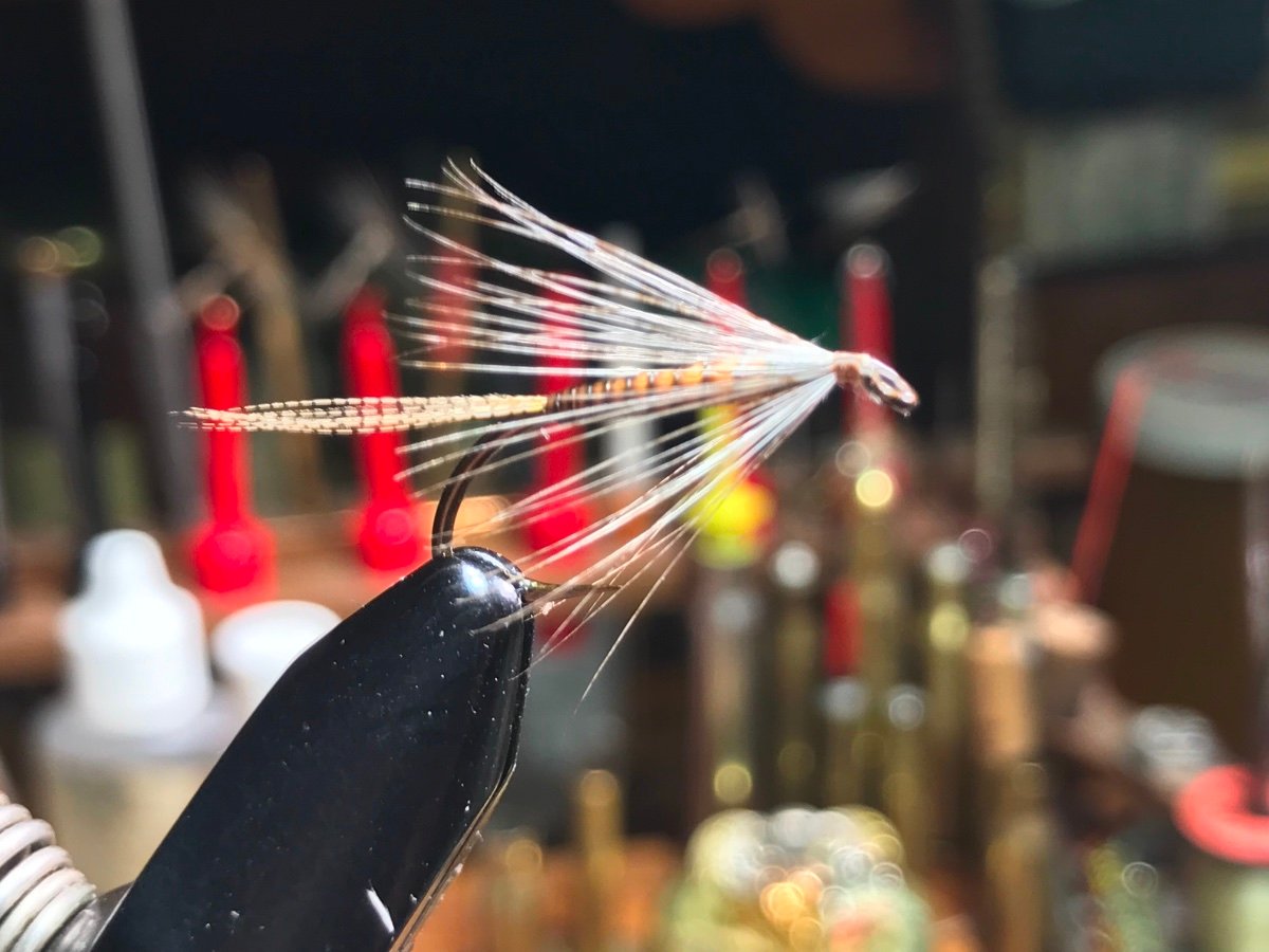

Yes - The hackle undulates back-and-forth.......That’s the main reason that Scotch tied hackle is soooo deadly!
[/quote]
The middle picture, the hackling on that particular fly is what you refer to as 'Scotch hackle'? I've always been curious as to how you got that effect. Any insights you'd care to share on how to wrap it would be appreciated.
The bottom picture, what hook is that? It looks like it was hand forged by Dame Julianna herself.

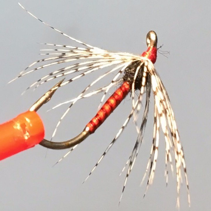

Will this pattern of ronr lay back as well?
quill body soft hackle.jpg (64.43 KiB) Viewed 14158 times

WiFlyfisher wrote: Tue Nov 27, 2018 9:11 pm What I like to do is submerge the flies in a jar water to see how the flies respond. In the warmer months I actually do testing in the river with real current to see how the flies act. At times I have used a GoPro or underwater point & click camera along a friend to assist so I can see how the flies respond in a real underwater situation. What we see above the water is a lot different than the flies underwater.
John
So would the partridge lay down against the abdomen in current? The pattern of ronr's?

WiFlyfisher wrote: Thu Nov 29, 2018 11:35 pm
Trifly wrote: Tue Nov 27, 2018 9:24 pm
John
Not necessarily.
See my post to help answer your question... viewtopic.php?f=7&t=8123&p=91453#p91453
John
I certainly appreciate your efforts. I wonder how the hackle responds in water that is a bit more turbid. Or, after a few hours with a bit of fish slime on it. I wonder if being pulled out of the water and given a high velocity ride on a fly line a few dozen times would make a difference.
How would this pattern hold up to your experiment?
Again, thank you for your efforts.

John-those are excellent videos you posted...... really quite nice and informative. I have a 20 gallon fish tank with the filter in it that simulates current flow to some extent, and it works very very well. I read somewhere in a book that some of our sports older luminaries had done that before and I learned a lot from it. I used to have a smaller tank next to the first tank, that I had a heater, and I would take nymphs and put them in the warmer water and watch them hatch to see what they did......That coupled with watching fish in the hatchery for days on end really improved my success ratio. I’ll see if I can get some video in the next day or two.....
BTW - Hackle on that fly is a very light speckled Darbee dun.
