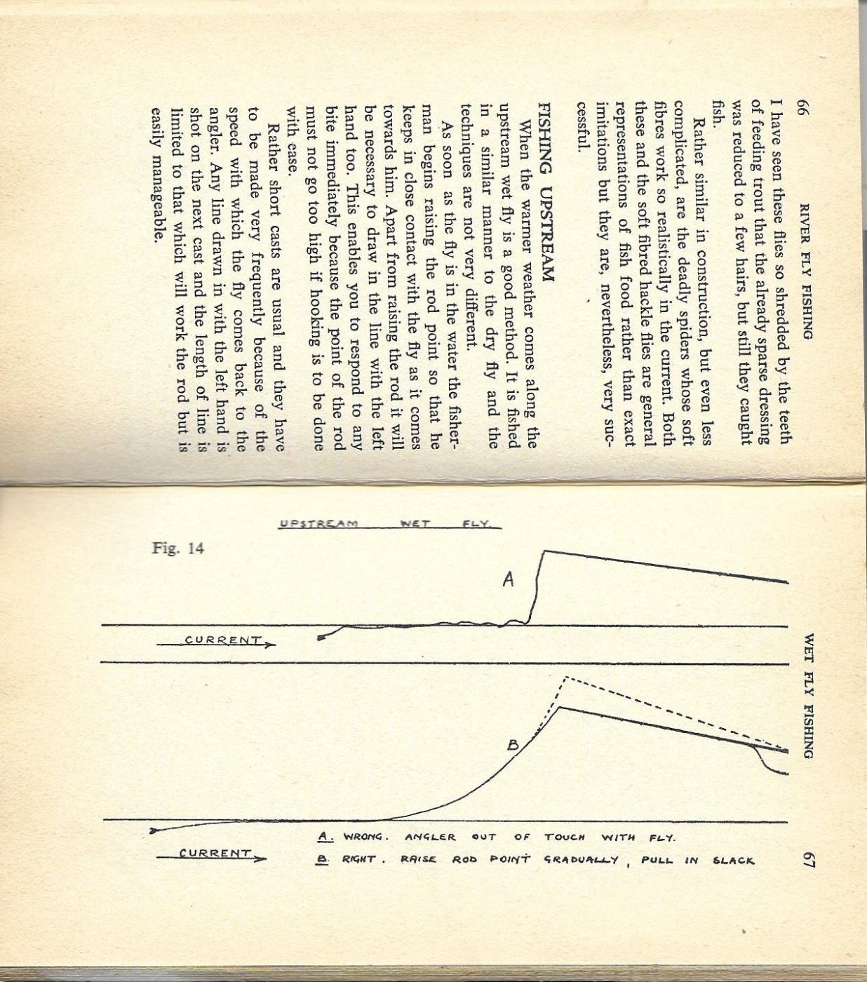

Fishing wet flies upstream seems almost impossible to many anglers but it's not really if one knows the basics of it.
I was looking through some books searching another topic and came across this diagram and brief description. As simple as the text and line drawing seem to be, here is the technique presented as well as I have seen it anywhere.
The book is River Fly-Fishing Theory and Technique by L. Baverstock. It is one of a series of small angling handbooks from the "How to Catch Them" series that was published in the 1950's and 60's. Some very good writers contributed to the series including Oliver Kite and C.F. Walker. These have become highly sought after and while only a few are devoted to fly fishing, most being about coarse or sea angling, they are interesting, and in some cases rare, little gems and collecting the entire series is quite a feat.
