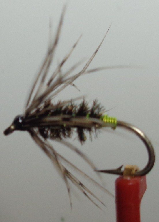

I'm sorry it has taken me awhile to get back to this post. Here is a sample of the fly I mentioned (locally called the Green Butt), and similar to what Bob posted. In the past, I've tied these on scud style hooks; however, I'm now trying this wet/nymph hook. I hope it will improve my hooking percentage, especially when the fly is hanging straight downstream (at the end of the drift).
Hook: Wet/nymph (size 14 1XL)
Thread: UNI 8/0 (black or olive)
Tag/Rib: Ultra wire - small (chartreuse)
Body: Peacock (2 strands)
Wound forward together, pushing thread forward as you go
Hackle: Partridge (2 turns)

Thanks for sharing that with us, Ken. Looks absolutely deadly!
