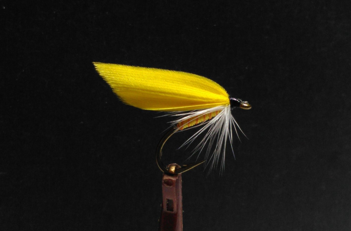

Posted: Thu Feb 03, 2022 10:27 pm
by Fishnkilts
I think I'm getting it.
I find I do better by pinching hard and slightly toward me, then two light wraps around the shank and then very quickly pulling up. If I pull up slowly the wings turn and lay flat no matter how tight I pinch them.
Keep in mind, I'm still practicing.
Re: Discouraged
Posted: Thu Feb 03, 2022 11:27 pm
Looks great. Nicely set wing, and no distortion of the fibers. Your efforts are paying off. ;)
