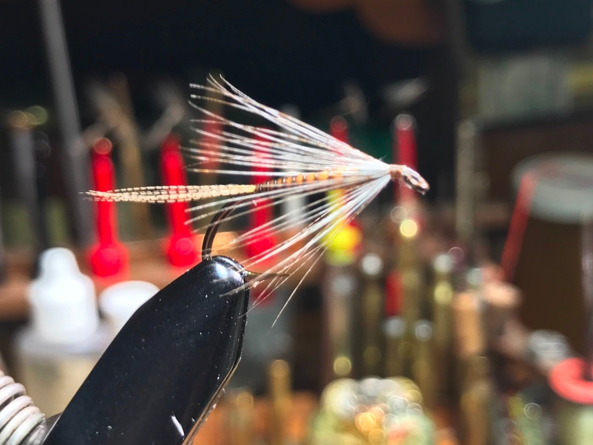

Yes - The hackle undulates back-and-forth.......That’s the main reason that Scotch tied hackle is soooo deadly!
[/quote]
The middle picture, the hackling on that particular fly is what you refer to as 'Scotch hackle'? I've always been curious as to how you got that effect. Any insights you'd care to share on how to wrap it would be appreciated.
The bottom picture, what hook is that? It looks like it was hand forged by Dame Julianna herself.

this is interesting to me.... the behavior of the hackle in the stream. Its pretty hard to simulate the action of a fly in a river by dunking it in a jar... or swimming it in the sink...
but, do you veterans of swinging wets want that hackle to cling to the body as in the pictures, or protrude a bit from the body...
I've been of the opinion that the hackle us going to undulate while moving in the current, given the impression of life....

John-those are excellent videos you posted...... really quite nice and informative. I have a 20 gallon fish tank with the filter in it that simulates current flow to some extent, and it works very very well. I read somewhere in a book that some of our sports older luminaries had done that before and I learned a lot from it. I used to have a smaller tank next to the first tank, that I had a heater, and I would take nymphs and put them in the warmer water and watch them hatch to see what they did......That coupled with watching fish in the hatchery for days on end really improved my success ratio. I’ll see if I can get some video in the next day or two.....
BTW - Hackle on that fly is a very light speckled Darbee dun.
