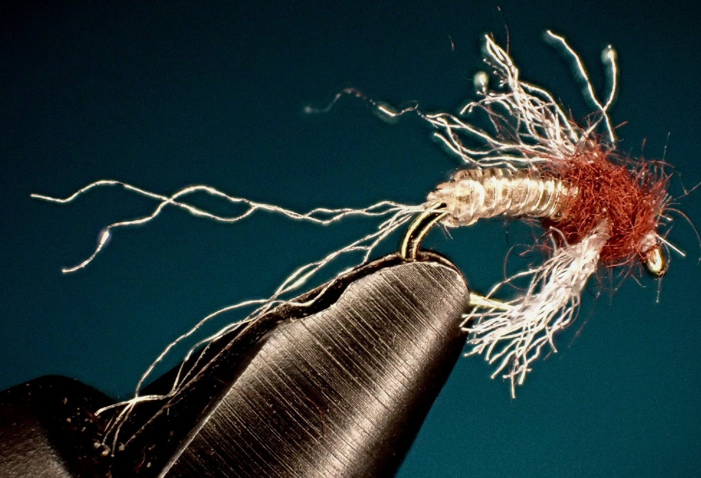

In the process of stealing these sunken beauties to add to my trico box, I came up with a variant of your brilliant! withered female, using clear midge larva lace filled with xs silver ultra wire for the abdomen. (Aunt Lydia's and mahogany Beaver dubbing for the rest.)
