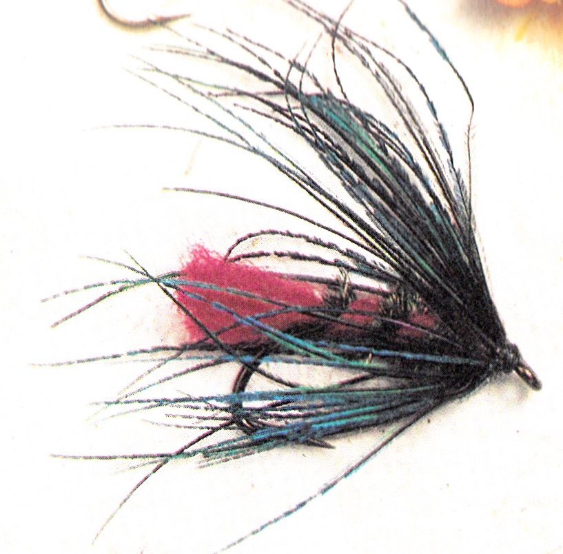

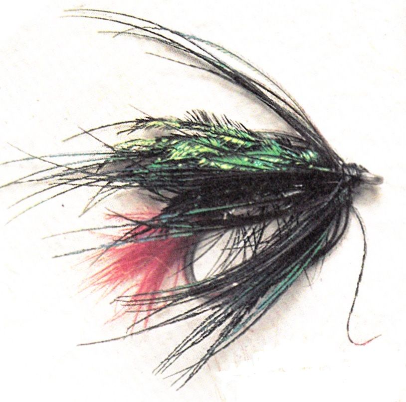

I have recently acquired Stan Headley's book "Flies of Scotland". It is an excellent book and contains good info on the "Goat's Toe". It shows this variant pattern, not wingless I am afraid, although it can be if you so desire. I have included Stan's comments at the end, no picture I am afraid, my eyes are giving me a few problems, I would love to dress this fly.

Here are the scans of the three pictures of the book of Stan Headley:

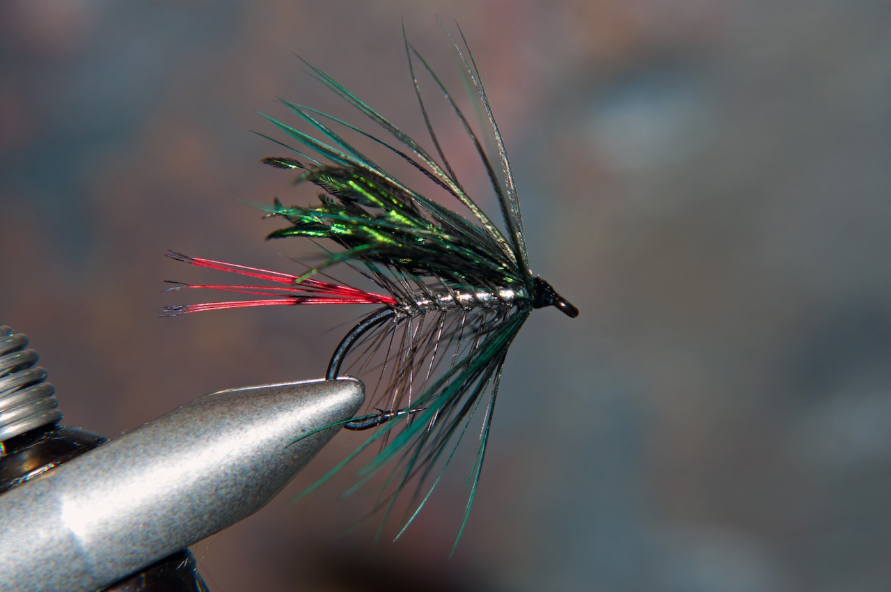

A little adjusting for fun and I put a couple of these in my steelhead box
Hook: #6 Ken Sawada Old Limerick Wet
Thread: Black
Tail: Golden pheasant tippets dyed red
Body: Silver tinsel
Body Hackle: Black saddle hackle
Rib: small silver braid cross wrapped through body hackle
Wing: Peacock sword
Hackle: Spirit River Super Slappen dyed blue

Re: Goats Toe anybody?
Post by Mataura mayfly » Thu Nov 15, 2012 5:01 pm
Now that is cool!!
Great looking fly, has many of the considered "good" attributes of several patterns all rolled into one. Looks like it should be a winner and very well tied Sir.
Keep us informed on how it fishes. :D

Post by hankaye » Fri Nov 16, 2012 1:28 pm
Old Hat, Howdy;
Looks to clinical and clean, please post a pic. of when it's been
chewed on and made more 'comfortable lookin''. :D , ;),

Post by letumgo » Fri Nov 16, 2012 10:59 pm
Carl - your pattern reminds me very much of the famous "Alexandria" pattern. I tried a while back, to convert it to a soft hackle pattern, but failed miserably. Your fly is brilliant! What a gem... ;)

Post by tie2fish » Sat Nov 17, 2012 8:32 am
Carl ~ That is an outstanding pattern, and I wouldn't be at all surprised if it doesn't become a well-know classic; it is that good.
