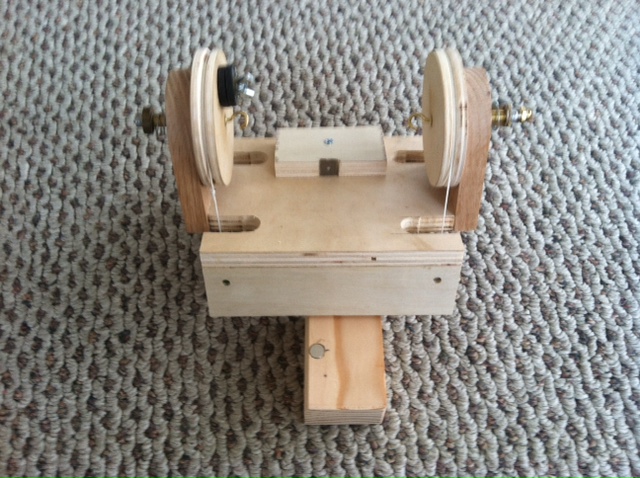

One last detail on the machine. I found the unsecured block a bit fiddley to work with. It wanted to slide around when I was teasing the dubbing into position. Lots of ways I could have addressed that, but what I ended up with was setting a small magnet into the back of the block, and a small strip of steel into a plywood backstop. That holds the block in place nicely, but releases easily to roll the block out of the way once the fur is trapped in the thread. The lower back edge of the block is planed off at a slight angle as well, to allow the block to roll out of the way easily. That might not have been necessary. Here, I am using the block to prop up the machine for the photo, and you can see the little disc magnet. Thanks to Ray for reviving the posting photos tutorial. I was going through Photobucket, which works but is a bit slower.

Tom, Howdy;
Nice way to avoid shifting and sliding Thumb up!
One drawback to the direct post is there is a limit,
not sure what the numeric value is so, just something
to tuck away for reference later.
