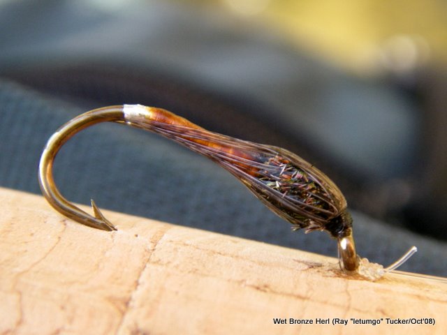

Bob - Interesting point about the peacock herl bodies. I've heard that each of the patterns you mentioned are great imitations for Isonychia nymphs. I believe it has something to do with the color of the peacock herl bodies once they become wet. I have noticed a pronounced change in the color of the herl fibers after a pattern has been fished (wetted). The body of the fly takes on a bronze/brownish tone in natural sunlight. I tried to capture it in a photo a couple years back (the fly is one of my POP series flies, tyed with a golden brown Kreinik silk abdomen). If you look closely at the thorax of the fly, you can see the brown/bronze tone of the wet peacock herl. I think this is a close match to the color of the Isonychia nymphs, which may explain part of the success of the patterns you mentioned.
Re: Isonychia Beaver
Posted: Wed Jan 05, 2011 9:40 pm
Ray, Howdy;
Thanks for the pic. Makes more sense than hocus-pokus ... poof! :shock: There it be :o . :lol:
That wet pic is purrrdy.
