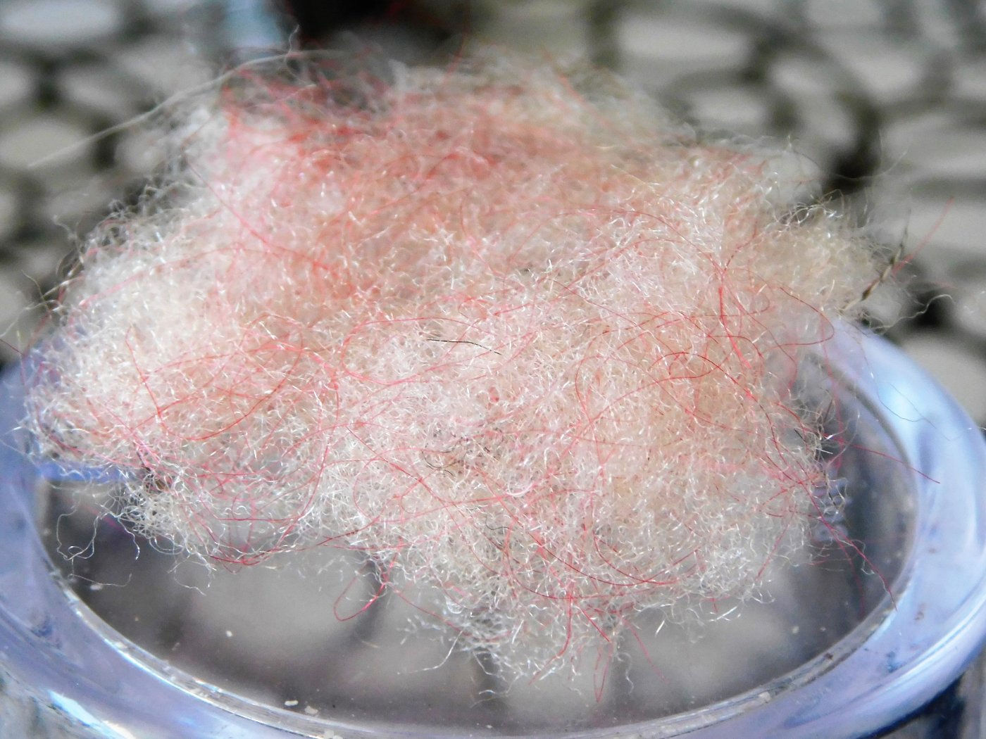

My Tup's mix.
Alan

:D sweet!
Beautiful blend.

Thanks to the incredible generosity of folks here I have a good supply of the necessary ingredients for Mike Valla's Tups dubbing, and have mixed up a few batches. I think I have it dialed in, with his recommended proportions but with the nuance that an additional half inch of red yarn is added at the end which is barely mixed, so that there are clearly visible red threads in the final mix (see, e.g., BrkTrouts' mix above). The Valla mix is also a good base for further experiments - for the Frying Pan Tups, for instance, I am experimenting with adding some tan rabbit fur to get that "dusty tan" look going. Your choice of silk will also change the end effect of course. I am playing with some ties to share but not there yet.
