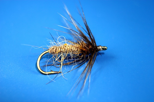

Post by chase creek » Thu Oct 18, 2012 6:22 pm
Hook - WR-011, Size 12
Thread - Griffith 14/0 Grey
Abdomen - 2 Strands Grey Yarn (Lion #403, Thanks Wm.) with Light Hare's Ear in a Dubbing Loop
Thorax - Hare's Ear Plus, Chocolate Brown
Hackle - Hen, Grizzly

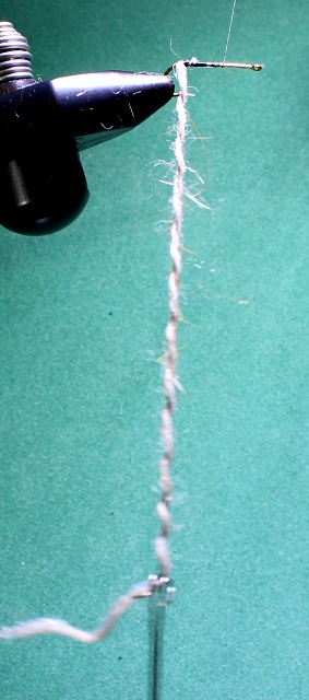

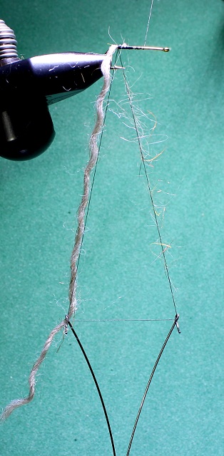

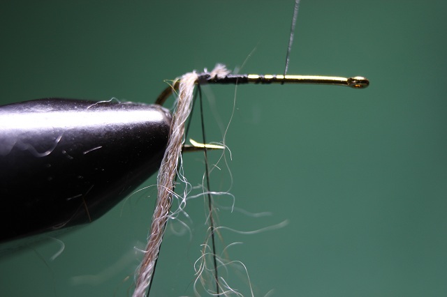

Post by chase creek » Thu Oct 18, 2012 6:28 pm
" 2 Strands Grey Yarn (Lion #403, Thanks Wm.) with Light Hare's Ear in a Dubbing Loop"
That's clear as mud.
The yarn was tied in where the loop was anchored at the hook, then laid along the side of one leg. The Hare's Ear was touch dubbed to the other leg, then the loop twisted while holding the loose end of the yarn tight along the side of the leg.
That doesn't sound much better, does it?
Re: Yarn and Grizz
Post by Mataura mayfly » Thu Oct 18, 2012 7:06 pm
No, I' only partly confused....... :?
So you twist the loop independent of the yarn and then wrap the two side by side on the hook shank "as one" so to speak?
Heck of a nice looking fly though!
Re: Yarn and Grizz
Post by chase creek » Thu Oct 18, 2012 7:37 pm
This should help - I'm not very good at explaining in words. I was a draftsman, so always spoke with a pencil in my hand.

Post by hankaye » Thu Oct 18, 2012 8:42 pm
chase creek, Howdy;
The things you are populating the forum with are
outstanding !!!
Liking the dubbing techniques... on the one in
this thread did ya put some dubbing on both sides
or just the right-hand side.....???
Re: Yarn and Grizz
Post by chase creek » Thu Oct 18, 2012 9:15 pm
Just the right side of the loop.
Didn't want to overpower the yarn.
