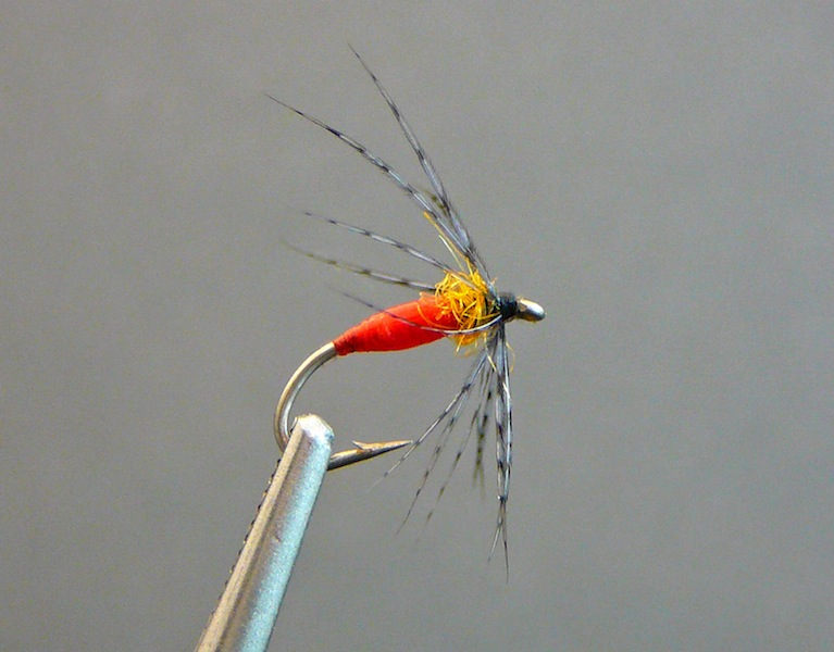

This is a pattern derived from a local steelhead fly. I have been experimenting with some Partridge that I dyed a blue dun. I am having a heck of a time photographing the partridge to get it's true color. .
Anyway here it is.
Lamplighter
Hook: Gaelic Supreme's Syl Nemes Soft Hackle Wet Fly hook #15
Thread: Black Griffith's 14/0
Butt: flouro fire orange floss coated with laquer
Thorax: orange seal in a dubbing loop
Hackle: blue dun dyed partridge

Outstandingly different, but visually appealing. :D
I have the same problem trying to photograph Pukeko to show its true colour, you have done well. Love the way you have taken a popular bigger fly and scaled/hackled it to suit another direction. With the floss being lacquered it should remain close to the colour we see it now once it becomes wet?
I like it, great photo and my kind of fly....... as you may soon discover if you have not twigged already through past postings of mine. ;)

Thanks, glad you like it.
Pukeko...hmmm... I have a little of that laying around, might look good on this pattern as well. I have tied a similar pattern to this with black seal in the thorax and a dark partridge or grouse hackle that is very productive.
Yes, the laquer soaks into the floss and really makes it translucent and durable. It retains the color you see here.

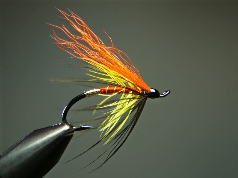

Here is one of the steelhead versions
Lamplighter 2.jpg (99.45 KiB) Viewed 4798 times

Good lord, these are amazing. The first does look like it would light a lamp, but that steelhead version. You'd be arrested for arson! Absolutely stunning.
