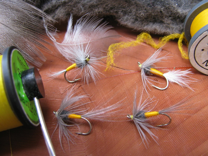

I was very interested and taken by the Half Stone Nymph as part of the Orphan Nymphs discussion. I noted the flies in Hidy's wallet the inclusion of several patterns tied with very robust, fine fur thoraxes. In the spirit of understanding a style of wingless wet-fly that I had not considered previously and as a way of taking the style from a remote period and to my current water, I tied up several versions that match the Half Stone construction, but like the Half Stone, seem weak in the representational dept. It's not likely intended as a stonefly, more like an emerging caddis, and as a nymph it's only slightly more plausible, but any other color combination would better represent most nymphs IMO.
I should have read this before, I forgot the content of this thread. There is great information that answers some of the questions: http://flymphforum.com/viewtopic.php?f=5&t=5319
Please pile on with your own opinions and comments, as well as other flies that help to further the thinking behind the persistence popularity of this pattern Style. '
Here are some samples. Each tied on a Vintage Mustad 57552 #14 and Belding Corticelli Buttonhole Size D Silk.
Half Brown
Furnace hen hackle, mole thorax and buttonhole silk #5210
Half Orange
Medium dun hen hackle, mole thorax and buttonhole silk #4425 (a pinkish orange color)
Half Pale
Light ginger dun hen hackle, beaver thorax and buttonhole silk #5330 (a very pale tan color)
Half Stone
Medium dun hen hackle, mole thorax and buttonhole silk #3030 (slightly more yellow than primrose)
Half Golden
Medium ginger dun hen hackle, beaver thorax and buttonhole silk #3715 (more golden-olive than a gold thread)
Any comments of further explanation about tying and fishing flies in this construction style would be greatly appreciated.

I would be more convinced of stonefly if the hook was a 2 or 3x long. Then I could see some obvious possibilities. The robust bodies, the carapace of the stonefly represented by the large fur "thorax" and then the leggy hackle. My stonefly patterns are similar to this however I always wrap the hackle through the thorax area to spread the legs.
In the profile above I would be more apt to say caddis pupae. No tail, robust abdomen, a large dubbed thorax (representing the thorax and budding wings which are folded along the sides), then the hackle for legs and antennae. It sure has a more grub appearance than a stonefly appearance.
The question of merit in fishing is no doubt to me. There have certainly been plenty of times where an abnormally meaty fly is very attractive to the fish for whatever reason.

I'm on board with Carl's caddis pupa interpretation for these chunky little beauties.

Here is the photo to go along with the commentary. Geert also tied a dry in the group.
