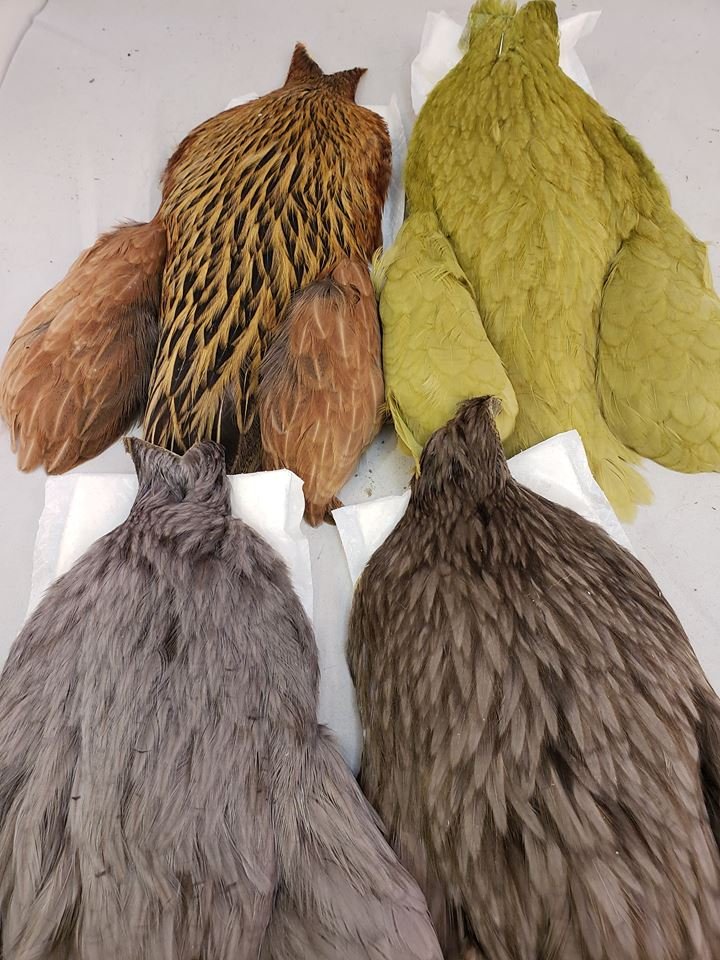

Re: Hen Capes
Posted: Mon Dec 03, 2018 1:17 pm
Oh wow! Those are some beautiful capes. Very useful colors. Thanks for posting. ;)

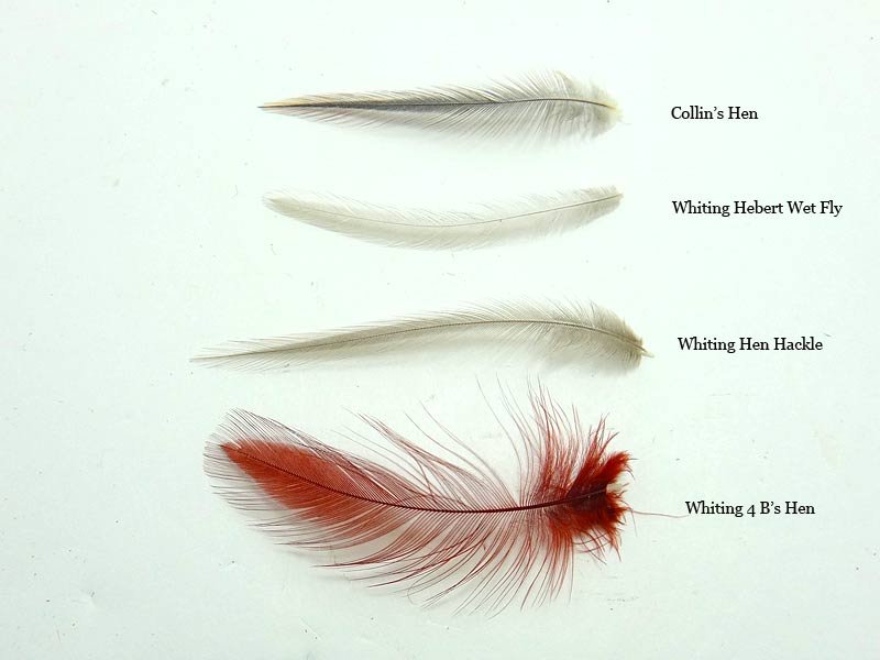

I have bought and used a few of the Collins hen capes. I was always disappointed in the and lack of uniformity from one cape to the next. That, and I was disappointed with the lack of feathers in the necks to tie down to 18.
Feathers, hooks and thread. We are indeed lucky that we can enjoy such a vast selection.
I found the photo a while back. It does a good job of illustrating the hen hackle differences.

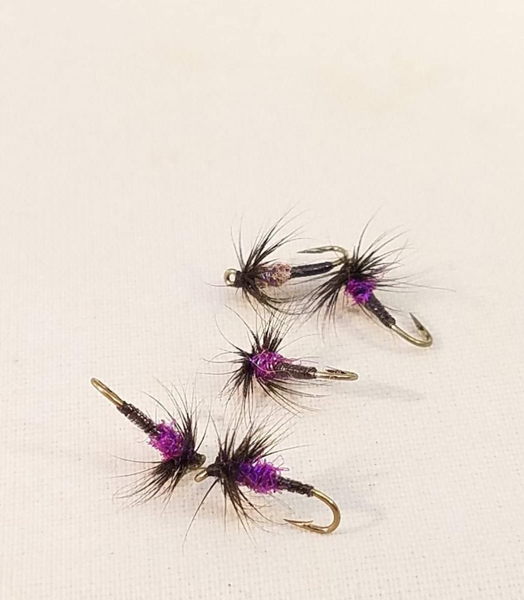

by Trifly
Size 18s tyed with 4B hen.
I think I used every barbule on the quil!
The bodies are thread with different resins that I am playing with.
Re: Hen Capes
Posted: Sun Dec 09, 2018 8:38 am
Trifly - That is really impressive! That would make a great searching/attractor pattern.
Recipe please... ;) :D
