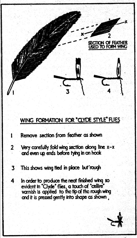

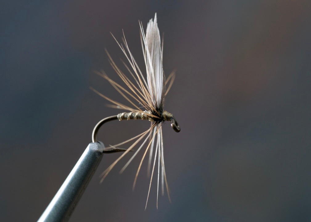

It is just a Clyde style folded wing but I'll try to tie one for you Hendrickson a get a photo up.
Re: Hendrickson soft hackle
Posted: Sat Jan 12, 2019 12:13 pm
You can put it in front or behind your hackle. It is a rather easy method but very functional. Its how I did this Greenwell's.

I'm not sure.
The wing on this one is tied folded and upright but I don't think the fly itself is quite sparse enough for Clyde style. Just wanted to make that clear. I wasn't trying to tie the fly Clyde, just using that wing method on it.

Posted: Sun Jan 13, 2019 4:25 pm
That's a killer looking fly Ray. Look at the shadow that thing throws. What fish would pass that up? Best of both worlds in how I would approach the hatching duns with a wet fly.
