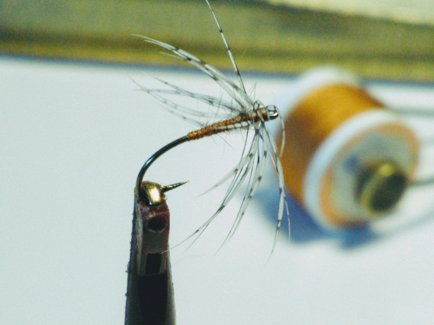

John,
I'm not sure I would change anything about the fly (beautiful), but if you are looking for options, you may want to try a version with waterhen covert feather for hackle. I believe waterhen would be a little darker gray, when compared with the mallard feather.
I like your choices for the body construction. Choosing the silk color (underbody) and controlling the overall color with the dubbing, works very well. As I look back and forth between the real insect, and your fly pattern, you have done a nice job matching coloration.
Have you dipped the fly in water yet? It is always worth checking fly color after the fly is wet, since that is going to be the closest to the appearance when fishing the fly. Materials generally shift (darken) several shades darker once they are wet.
I love this sort of tying mimicry. Your insect photos create a strong foundation, for imitative tying.
Good stuff!

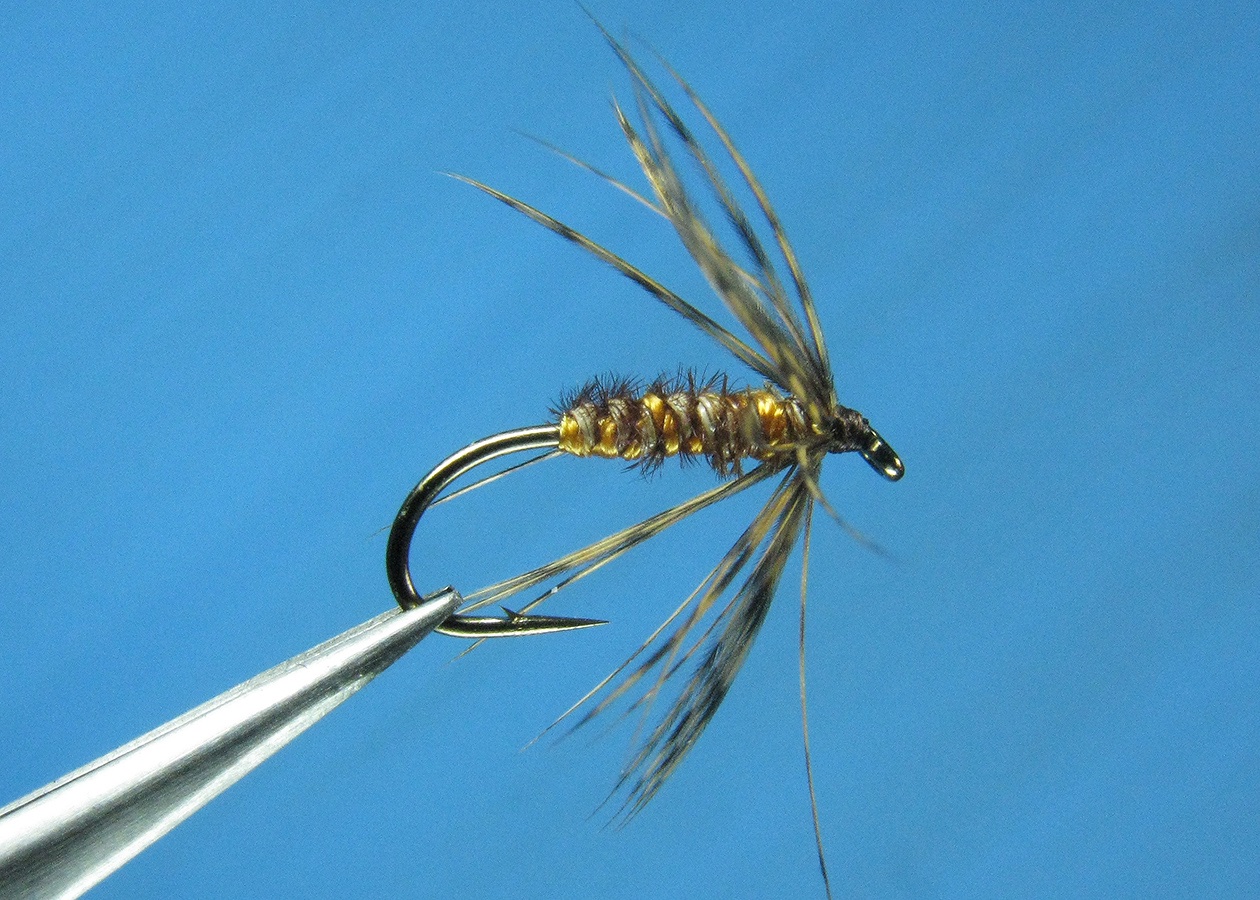

I don't know those northern freestone rivers like you, but on the rare occasions I encounter Hendricksons in the spring creeks of SW WI, this is my current choice for trout feeding under the surface. It's similar to your fly, but with woodcock hackle.
This is one of Thomas Pritt's several March Brown patterns (his fly No.13):
Hook: #12-#13
Thread: Orange silk (Gossamer #19 here, which will be deep rich ginger when wet)
Body: Orange silk, dubbed over with a little fur from a (red) fox's ear
Hackle: A reddish feather from the outside of (an English) woodcock's wing
Cheers,
Phil

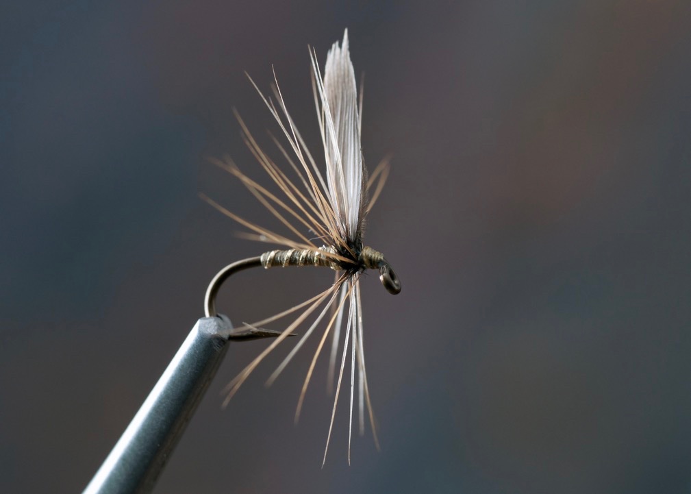

This is the Hendrickson soft Hackle I have used for the last couple of years. I am very happy with it.

Thanks for the additional photo, footage and info John, very cool...
I think how you are intending to fish your flies will work well but I would also consider creating some that sit higher but are still soft hackles. You may fish emergers and haystacks when they're willing to look up. I have a at times caught more fish on adapted soft hackles that employ hackle fibre tails some seals fur dub and maybe a turn or two of undersized cock hackle. These flies have worked extremely well for me on some very tough fish, they usually sit in or just under the surface. I sometimes like to cast well ahead of a fish give the fly a short sharp strip to sink it and trap airbubbles and hopefully the rest goes to plan, and it often does...
